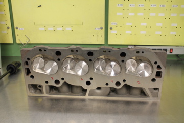

For several years I've been building 9.2 compression 467s with 236 peanut port heads, these engines use a 228/238/114 hyd flat tappet cam with a performer RPM intake typical HP was about 517-518 corrected HP, with about 560 TQ. Finally it looks like I will get to test one in my 68 Chevelle, 3720 pounds at a 2130 foot track. My goal is a high 6 sec pass in the 1/8 mile. Some pictures of the build.
