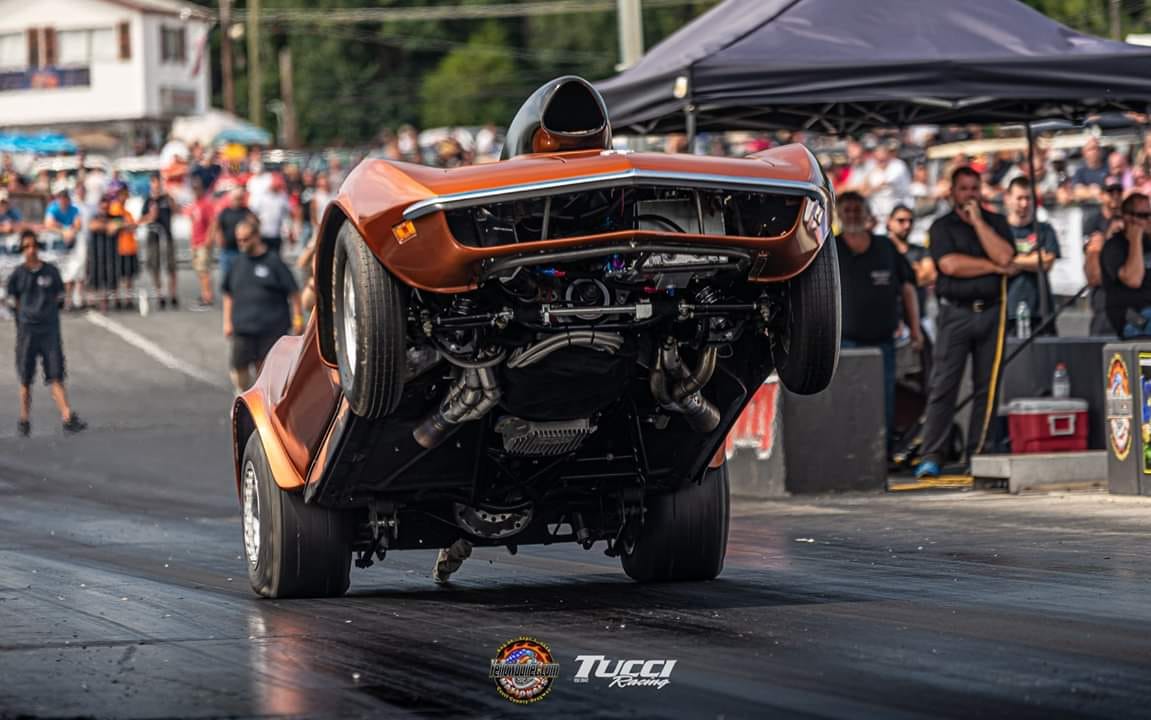

Here is a pic of the car NOT doing what we want it too

No worries. We looked at possible doing the 4 link deal with short upper links. Decided against it as we have the car working well for a small block anyway. Was alot of work, with not a huge possible upside for us. Honestly they make horrible racecars for what we do.
Nice Corvette. By chance do you have more build details and pictures?
