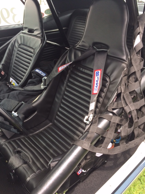

Ken, I also used the Jaz seats that 1320 is referring to. I like that they're not as tall as others. MJ Quinn from Derby City Covers did the covers. I would imagine he has a pattern for them now after doing mine. I had to send him a seat as he had never done covers for that particular seat.
Joe Martens AA/Stock 3969
