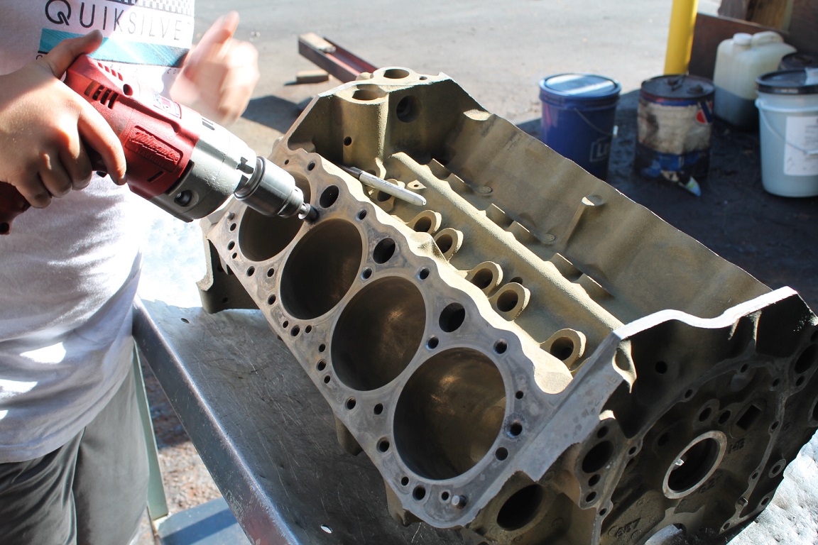

I've always been fascinated by first generation Z/28s, which brings me to my first engine rebuild, a 1966 October 657 casting block with matching 462 casting heads. I will post pictures as I go along. The first pictures show the core cleaned along with the block prepped for machine work which I will start this coming week.

Why are you starting with a 2 bolt main block, 302 came with 4 bolt? The original blocks where 618 castings in '69. I'm not questioning your build, just pointing out different items, but in 1966 maybe they used 2 bolt blocks.
Also, if you are using an older block be sure to test the walls for pin holes. I personally got burned by the pin holes twice.

Old 08-15-2018, 09:50 PM   #9
MIKE JONES 302
Join Date: Aug 2018
Location: Colorado Springs Colorado
Posts: 28
Liked 85 Times in 15 Posts
Default Re: 302 Chevrolet Engine Build
Originally Posted by Todd Hoven View Post
I have a fresh lg journal 302 crank for sale if you need it. Just balance and go. PM me if interested
Thanks, but I have a crank. I will have it ground and indexed, and the stroke will be set at 3".
