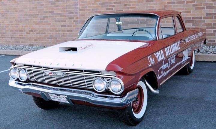

Speaking of the maroon Chevy, here's a color photo from Indy at the '61 Nationals taken in the pits.

Correct me if I'm wrong but I think that Don Fezell owns that car and has restored it.

Don owns the clone of the OR1, the original car has never been found. Don does own the original OR4.

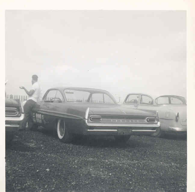

Here is a shot of the clone.
The Pontiac pictured was owned by Mickey Thompson and driven by Hayden Proffit. It set low et. in O/SS at Indy with a 12.55. Some feel this time was bogus and that the car tripped the staging beams with it's rear tires.
