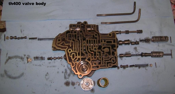

Default How to disable Turbo 400 kick down?
On my street driven 69 Chevelle with a 496 ( plenty of power ) I don't want the kick down functioning.
I've already disconnected the kick down solenoid , now I apparently still have "modulated" kick down function.
How can I completely disable the kick down?
Thanks in advance.

Did you try screwing the modulator adjustment in?
Might have to screw it out, then re-work the governor, now that I think about it.
Not your normal S/SS question, Joe.

Why don't you call a local transmission shop?
Because.....its Fri. night , its 10:30 and I want to know , now.
The modulator and "kick down" function isn't so clear to me.....I wanted to delay the 1-2 shift so I increased modulator tension , to solve that.
Now how all this relates to eliminating downshift / kick down......I have no clue.

Well , you're in luck then, Joe because I'm here in Az.
Find the 3-2 valve and block it so it won't move. 2-3 should work fine with absence of gov. and mod. pressure for downshifts after slowing.

Like Mark said just block the 3-2 downshift valve.
Small valve at bottom right of photo .
I use a piece of 3/16" brake tubing ,about7/8" long , file it for a final fit .
Been doing this for years ,works great .
Thanks guys.......in this view is the mod present? Where is the tubing?

Sorry ,been off line for a while ,Damn Work ! No it is not shown in the picture . You substitute it in place of the spring .
When I get home , I have a good picture of it I'll post.
