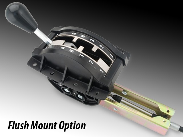

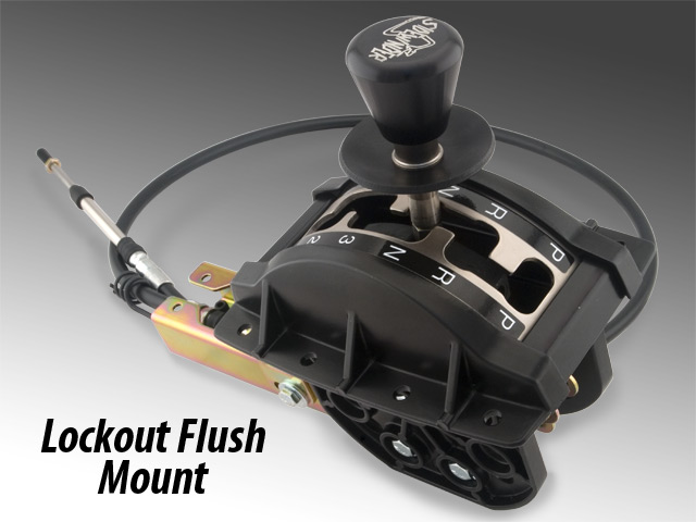

Logus
Join Date: Jan 2010
Posts: 19
Default Re: Winters sidewinder shifter mounting
They have a new mount.
http://www.lyonsperformance.com/univ...te-p-1050.html
Name:	Winters Sidewinder Flushmount.jpg
ID:	23819   Click image for larger version
Name:	Winters Flushmount.jpg
