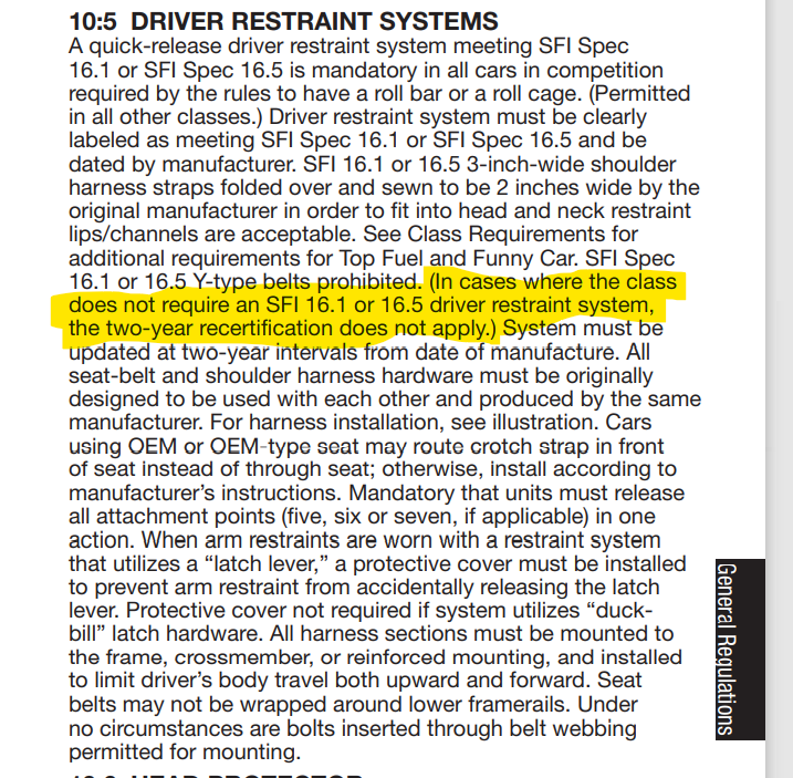

Can not offer any mounting suggestions but I wanted to pass along belt certification info.
You can use a 5 point out dated belt in N and slower classes.
Not all Track tech inspectors are aware of this. This came directly from our NHRA Tech Director.

Is this in writing somewhere to show uninformed tech inspectors?
It's in the rule book.
