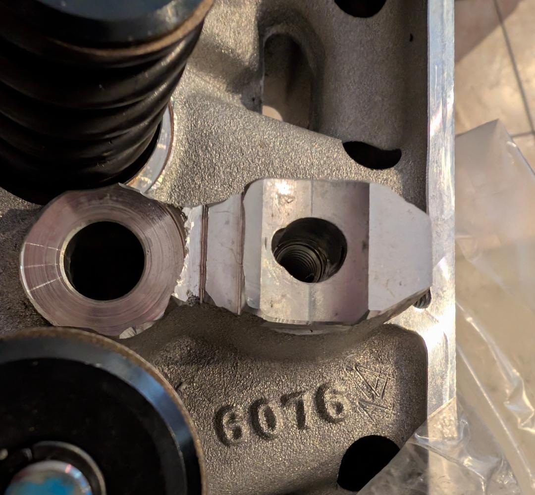

All the approved SBM are based on the Edelbrock Performer RPM 6076 casting, which has a catalog part number 60769 assigned to it. If you look in the rocker arm area, you will see the raised casting number 6076, and you will find it in all the SBM Performer RPM cylinder heads.
Also, the outside of the cylinder head does not reflect the actual catalog part number; the additional digit in the catalog part number reflects the configuration of the cylinder head as sold by Edelbrock. In a nutshell, all the SBM Edelbrock Performer RPM cylinder heads use the same casting.
Moreover, the difference between P/N 60197 and 60767 is the combustion chamber size.
Name:	SBM RPM 6076.jpg
