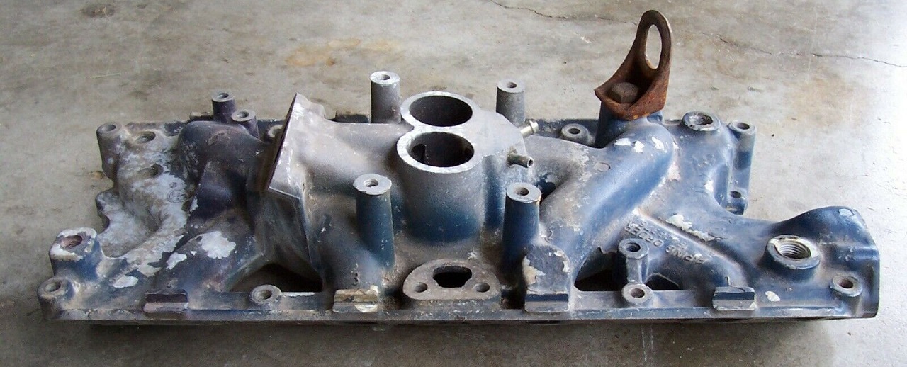

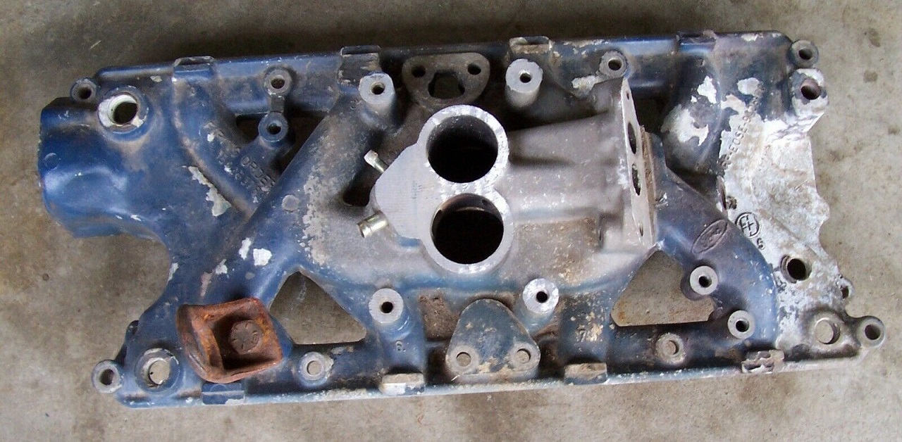

Jim, easy way to tell a 255 from a 302, is the 255 intake manifold has open webbing between the runners, kinda like a "air gap" style intake, with the intake gasket having a steel valley cover underneath. 302 has a solid intake like most other V8 engines, other than 383-440 MoPars.
That intake deal came up on one of the hot rod sites recently.
I had never heard of it . I searched for a pic but today's Google...forget it.
Anybody have a pic? Just curious..That's all. The 255 is rated higher than most of the 302 2bbls...Nice going'..You know who

Here you go Mark.
ID:	61839   Click image for larger version
