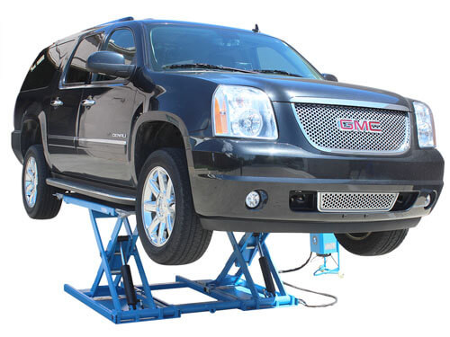

Larry ,I've got one of these lifts at home for the race car , but it works great on almost anything . and it is portable.
Had it since 2012 ,no problems .
https://www.gregsmithequipment.com/A...-Mid-Rise-Lift
