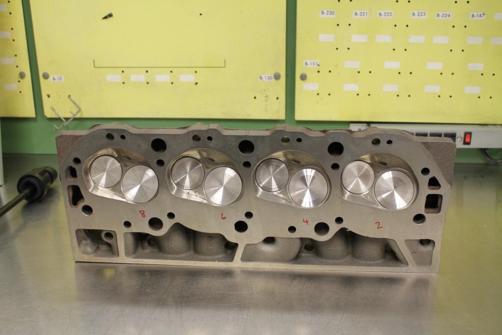

You will use a open chamber piston. The head will have to be clearanced back behind the exhaust valve to clear most pistons.
Example:
Name:	vp chamber 236.jpg
