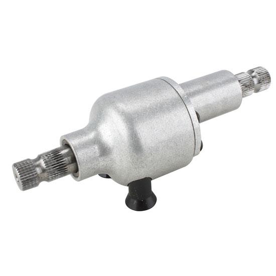

Originally Posted by Jeff Teuton View Post
I had trouble with steering my car this year, made one race and had to give up the year. It's a Challenger which never came with standard steering, so no power assist and no hydraulics. Now all new cars have electric power steering. We made an electric power steering system with a switch to turn it off. Anybody have a problem like that, pm me and I can give you the details.
Mr Jeff, the circle boys have a much simpler solution , a ratio multiplier .
They come in either 1.5 to1 or 2 to1 ratios and fit inline with the steering shaft.
This one from Howe Racing Products costs only $100 .
Name:	steering quickner.jpg
Tom, Wouldn't you want something slower, for less steering effort?
Maybe a 1.5 , in reverse?
Old 11-20-2018, 02:40 PM   #9
Tom Goldman
Tom Goldman's Avatar
Join Date: Jan 2003
Location: Allentown,PA
Posts: 2,479
Likes: 900
Liked 889 Times in 239 Posts
Default Re: Power Steering
Mark, think of it like a transmission . if the power rack only has, say , a 4to 1 ratio the reducer at 2 to 1 will make it move like a manual rack with 8 to 1 reduction.
But technically ,yes, you will use it backwards to increase the ratio , not decrease it .
The reducer is used by the circle racers to slow down the steering on big tracks .
