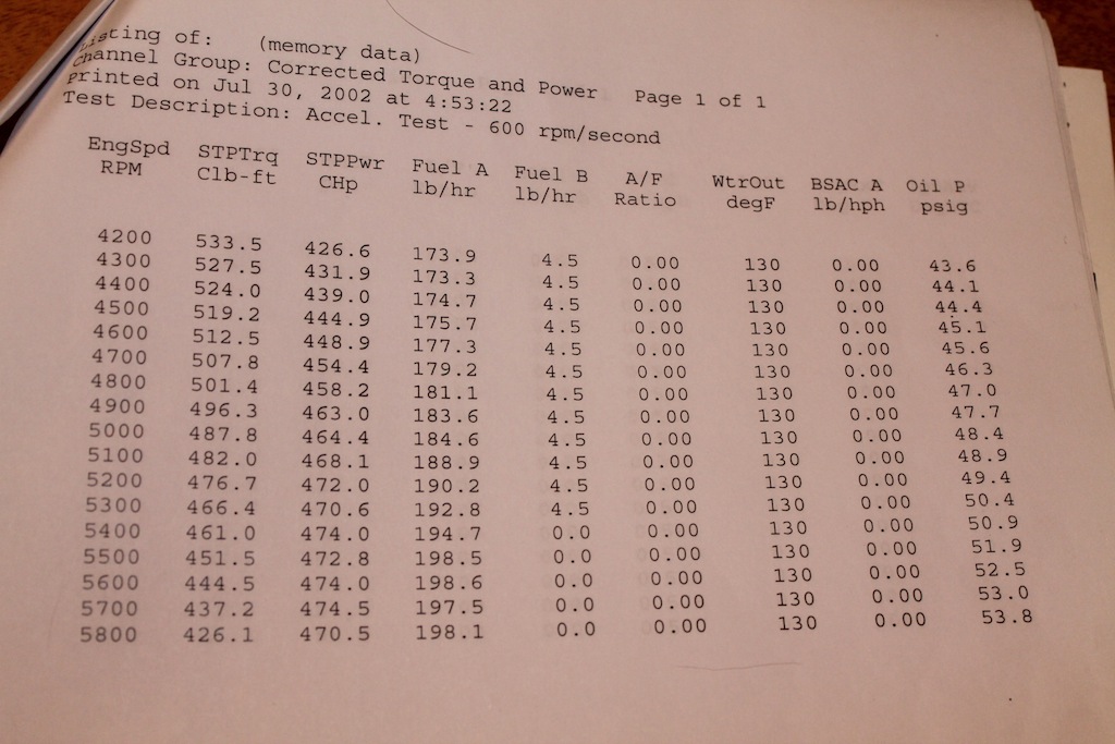

A few years back I bought a 1971 Buick GS 455 stocker 315/330 HP. After taking delivery of the car I rebuilt the rear suspension, changed the fuel system, rejetted the carb, put on fresh tires and headed for the track. I was surprised when the car ran 11.35 on a 11.85 index (F/SA) on a 2130 foot track with a 27.80 baro in July 4500 DA, although the car was 135 pounds light for F/SA. I put the car away for a few years but couldn't help but think the car had potential if the engine was legal. This last week I got the car out of the garage and pulled the engine and put it on the dyno, then a tear down to determine what I was working with. I will post pictures of my engine build as I go, I will be looking for 30 extra HP out of the engine, if I can get that I will then look very hard at the drive line. I can't help but think if I can get a few hundred more RPM peak out of the engine I can then gear up to a 4.30 gear with more converter. Any advice or information on this build will be appreciated. Dyno test as the engine was pulled from the car.

Default Re: 1971 Buick 455 GS F/SA G/SA Build
Got any more dyno pulls with a broader range of rpm? Ie lower and higher.
I do have some tests I started @ 3800 but If I remember right I ran the car from 4200 to 5800 on the track. I really didn't want to run it past 5800 until I went through the engine, after its freshened you can be sure it will be run much higher than 5800, in fact I need more RPM to make the driveline changes I want to make. I do have the top end off the engine now and everything appears to be legal. When I look at whole combination of car and driveline and engine I can't imagine not being able to make it faster. I will mention while testing I leaned the carb down, I had a 67 jet with a .062 rod and it picked up from the race setup and I had no jets or rods to go leaner, I test @ 6400 feet elevation. I will look and see if I printed any of the tests starting @ 3800 RPM, if I have them I will post them.
Gear the car where the engine wants not where you want it to run.
