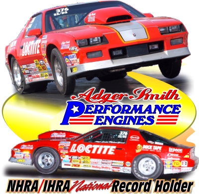

The first picture is not legal the second

This is legal Both scoops in the pictures are mounted on Glass hoods.
I have seen a cowl hood be deemed legal, but it was just like said by FED... under 11 inches
