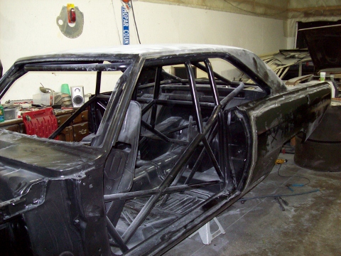

Im working on a dart for superstock with a stick.What would be the best motor combo 340 383 440? I dont need to set a record at this point in time however must be respectable.

Thanks for the info I hope to get more feedback!

I still think you should go with a 383 in that. I see a hunk of scrap metal sitting behind the Dart.
