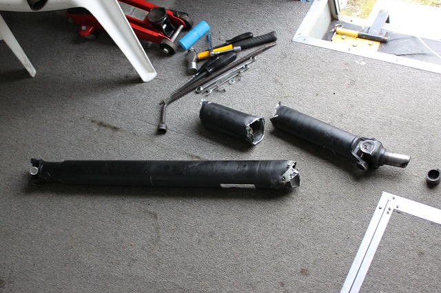

Well the rain is holding out enough that racing has been happening...thats the good news. I feel a little like Drooze and company ,so far 4 passes and 4 passes worth of broken ****! I was first pair this afternoon with Angela Bushmaker and 'BOOM" lost a drive shaft.....no leaks but what a mess underneath the car and maybe kissed a valve we will see (picture below). Like last year I am attaching a link to photobucket so check them out...this isnt all the cars some where hiding from the potential rain, I will try to get the rest if I can get my 'Part Breaker' fixed tommorrow. http://s694.photobucket.com/albums/v...%20May%202010/

So thats what happened to you Dion. I`d take a close look at the case of your transmission, I had a driveshaft break like that in my 66 Fairlane 390 back in the 70`s, and when I looked, the bellhousing area was cracked from pan rail to pan rail. Mine broke going into high gear, and that rear section banging of the rear floorboards sure makes a racket, doesn`t it!? Dave Jungs Malibu broke a driveshaft like that a few weeks ago, and his trans case was broken too. Hopefully your trans is OK & you can get another shaft for the weekend.

well day 2 was a rain out all cars were in the trailers except mine, we were busy swapping in a brand used transmission because of the second broken case this year. It looks like tomorrow will be a one hit then eliminations. The joke was with all the work i've been up to this week i'd be last man standing, heres hoping but good luck to all tomorrow!
