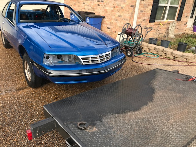

Thanks to all for the comments. The following photo will show what I have in mind. I titled the post Mustang strut because it is a Fox platform and uses the same strut as a Mustang. It an 88 Thunderbird that I am considering building as a fast bracket package. Work on this car began years ago but it fell on hard times. I am considering reviving it.
