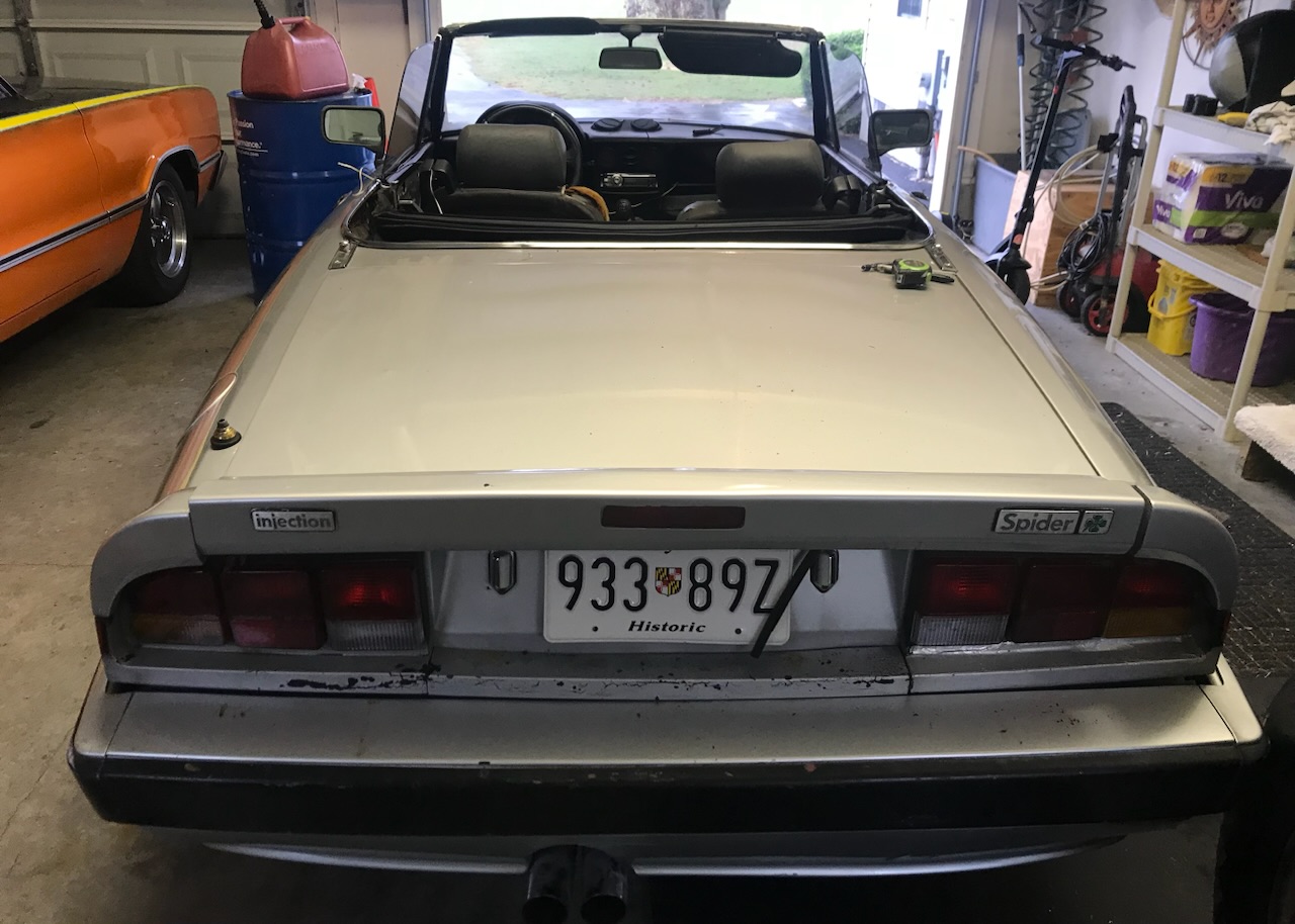

Hey guys, I’m only about a month away from finishing my new car and figured I would share the build. This car is intended for super street and super gas so it will be a little on the heavy side. I decided to use all mild steel and sheet metal interior to try to get my weight up to 2800 pounds. I will start from the beginning with some pics and go from there till completion.
So here we go with the start I found the body over the bridge near Baltimore
I bought a 27 roadster kit from Chris Alston chassis works knowing I’m going to have to change a lot of the sizes and bars to accompany this body. I decided to stretch the wheelbase as 88” is just way too short for my liking the Porsche is now at 97 and gets out of control so as you will see as the build goes on, I have stretched it quite a bit.
