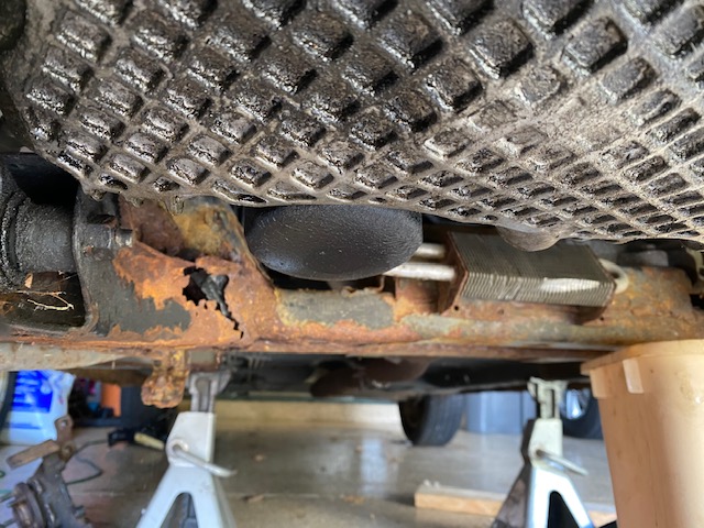

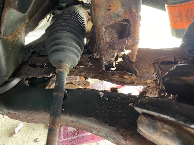

I've looked at some tuners for Neons but haven't got to the point of getting serious about getting something yet. I'm working on getting it drivible. Rear brakes have been fixed. Replacing the K-frame is in the works. Pics are what the current K-frame looks like.

yes that looks bad---surprised it didn't collapse when they put it on the lift

Just a quick update on my project – Badly rusted K-frame has been replaced. 20 year-old rusted bolts made this way more of a job than it should have been. But it’s done along with new axles, new front brake calipers, rotors, pads, struts & tie-rod ends. I did drive it around the sub a little today (no plates yet). All seems OK so far.

rust holy crap was it parked under water ? Have fun with your build !
