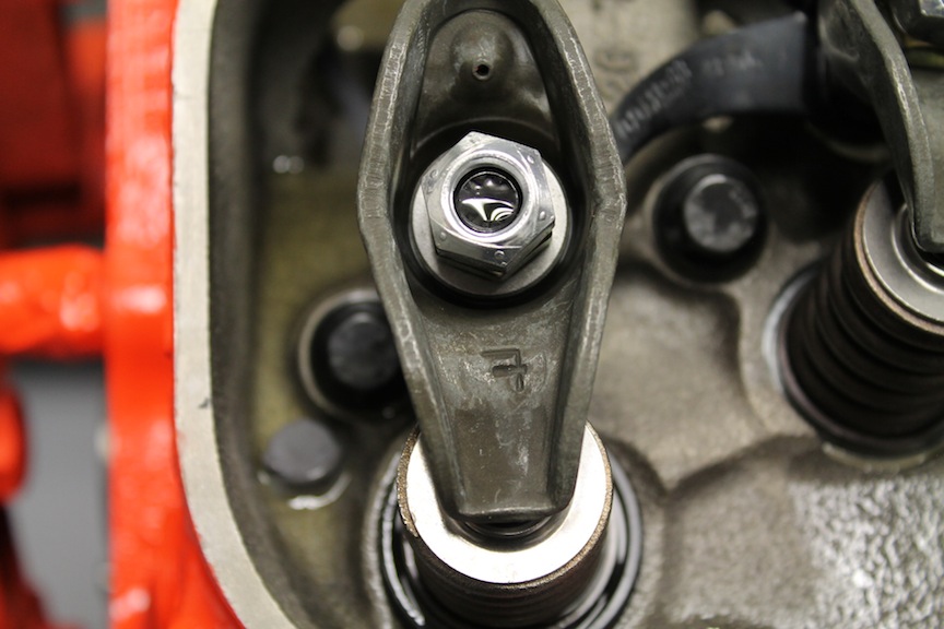

For several years I've been building 9.2 compression 467s with 236 peanut port heads, these engines use a 228/238/114 hyd flat tappet cam with a performer RPM intake typical HP was about 517-518 corrected HP, with about 560 TQ. Finally it looks like I will get to test one in my 68 Chevelle, 3720 pounds at a 2130 foot track. My goal is a high 6 sec pass in the 1/8 mile. Some pictures of the build.
ID:	30859   Click image for larger version
ID:	30860   Click image for larger version
ID:	30862   Click image for larger version
ID:	30863   Click image for larger version
ID:	30865   Click image for larger version
ID:	30866   Click image for larger version

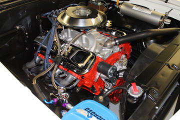

Ready to race.
ID:	30914   Click image for larger version
ID:	30915   Click image for larger version
HP HUNTER is offline   Reply With Quote
