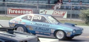

There was a D/MC as well, this is Ken and Toby Meeks 2000 CC Pinto, Robert Swartz can tell you more about this car if he is lurking. I believe it still exsists, perhaps in Chicago?
I am pretty sure there was a AA/MC class as well.
