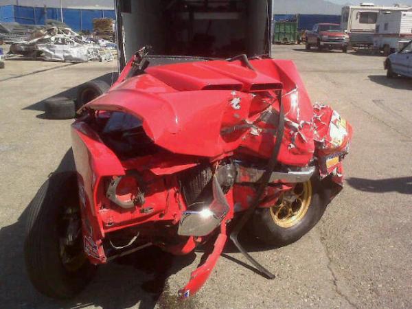

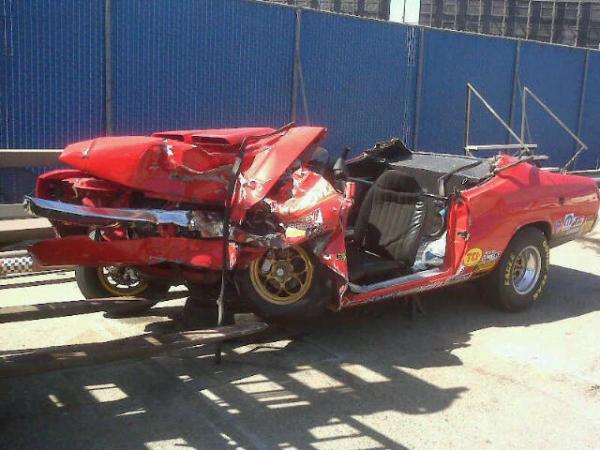

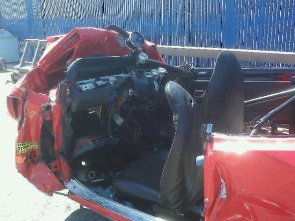

How much is safety worth to us. After reviewing Ken Etter's pictures from his accident, I've come to the conclusion that a freak accident can set us back or even worse cut our lives short. I read what Angelo Ditocco had to say in another thread on what he wish NHRA should allow for his Super-Stocker wish list, are things to do were mostly for safety related items. I've decided to go with a 12 points roll cage in my stocker instead of the lighter 6points mounts, why take a chance and I'm sure the extra strength won't hurt. I know that in my previous race cars that safety sometime took a back seat to performance. I know I'll pay a little more attention to checking and rechecking for malfunctioning parts in the future.CR

My Demon has a full CM cage, It has 2x3 subframe running welded thru floor. Cage is attached to subframe by 2x2 square tubing. It has four extra crossmembers connecting cage to frame rails. I'll post pictures after World Finals and anyone is invited to check it out at race.
Most of Kens injuries were from steering column sustaining direct contact with Concrete K rail then completely collapsing crumbling segment and then being thrown into Ken's face like a Javelin breaking his full face helmet and then his Jaw.
I am not an engineer but I have to think that front frame rails extending near front of factory frame there would be afforded some protection for the column which is the worst part of front of car to use to absorb the force of impact. I will try to post some pics of Kens car which I purchased after finals.

I met with Bruce B at the national race last week. I gave him some pictures that are much more graphic than the ones floating on the net. I gave him 4 suggestions based on my experience. 1 Racing seats (mine were folded up and didnt do a good job securing me) 2 Full face helmets 3 Allowing forward bars on a cage 4 take the batteries out of the front ( Mine exploded on impact sending acid everywhere and started a fire. Unsafe for the driver and the safety crew trying to help. Plus how many people have dropped a wrench on the battery when working? I have. Put it in the trunk and make it safer for the drivers,mechanics,tech inspectors during teardowns. Just my 2 cents.
