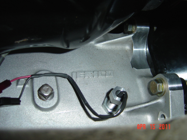

This works for me. Instead of mounting the fragile $80.00 sensor on the input shaft I mounted mine on the side of the case so that it reads a split collar on the cluster. The spud pictured is counterbored and tapped to accept a standard RacePak driveshaft / clutch sensor. The RacePac program is able to correct for the M/D ratio of the cluster for a direct single line readout as if the sensor was reading from the input shaft.

Mark,
I actually had thought the same thing accept I bought a couple differant split collars and they are way to big, along with not having much room between the cluster and main shaft gearing. If you could point me towards where you got the split collar I can make the rest. This would GREATLY appreciated!
Dirk
Dirk Olson 5036 STK
Dirk Olson is offline   Reply With Quote
Old 04-15-2011, 05:12 PM   #9
Mark Madison
Join Date: May 2009
Posts: 91
Likes: 78
Liked 32 Times in 9 Posts
Default Re: Racepak for stick cars
Dirk, I made my own collar. As you know all the commercial ones are way to big. The collar must be 2.375 o.d x 1.750 i.d x.375. with a small notch in the i.d so the oil relief hole in the counter shaft is not obscured.
