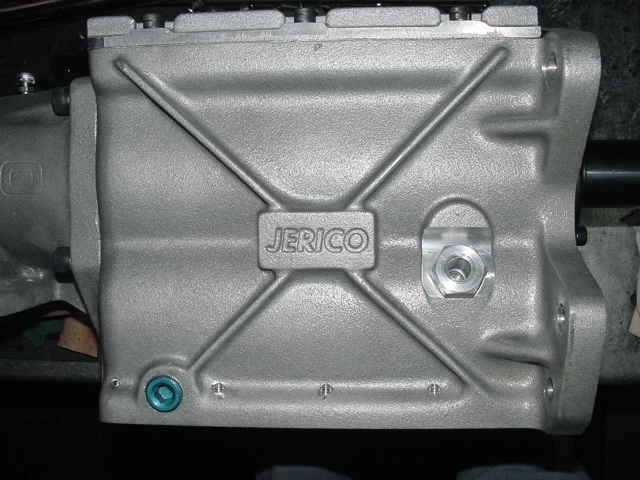

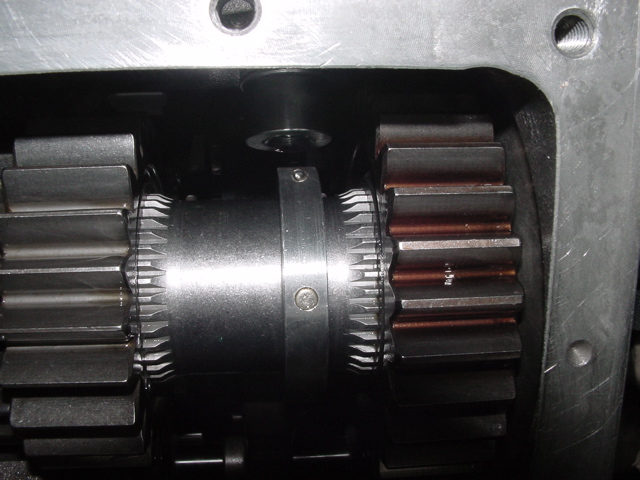

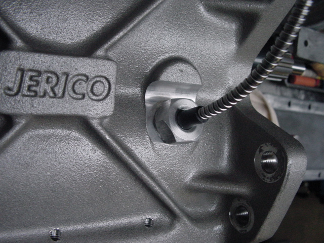

Default Jerico modified for Racepak
A top and bottom loader Jerico modified for Racepak sensor by re-machining the cast-in fill plug boss.
