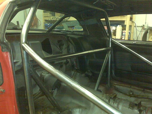

I installed a S&W kit in my '77 Camaro last winter and it was so easy it was fun to install. The tubes were bent perfect and only minor trimming was needed to fit them in. I will use there kits on any project in the future and highly recommend them to anyone who asks!
