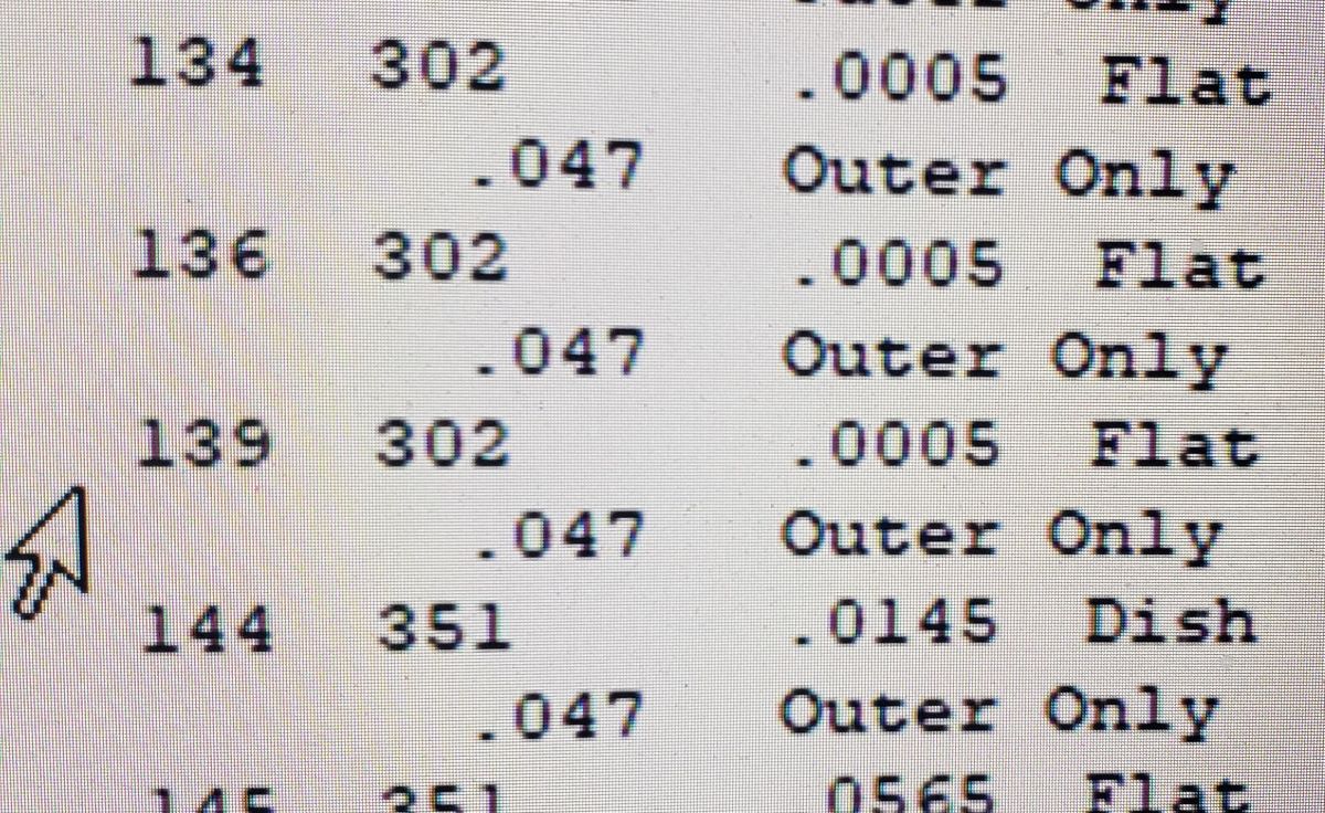

Need help with the deck height , NHRA list a 302 at .047 Gasket ,and the deck height at .0005 is this correct

Old 03-31-2025, 06:58 PM   #2
Dwight Southerland
Dwight Southerland's Avatar
Posts: 2,002
Likes: 64
Liked 783 Times in 195 Posts
Default Re: 139 hp 302 ford help
Yes.

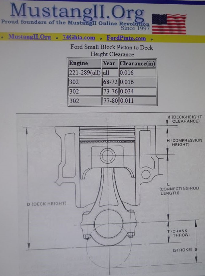

so the piston is five tenths above the deck

Old 03-31-2025, 11:16 PM   #4
Mike Gray
Mike Gray's Avatar
Join Date: Oct 2006
Posts: 629
Likes: 321
Liked 711 Times in 205 Posts
Negative vs. Positive Clearance:
Negative clearance means the piston protrudes slightly from the deck surface, while positive clearance means the piston sits a bit inside the cylinder bore.
The .0005 on the chart appears to be a positive number so the piston should be below the deck. I assume if it’s assembled .0005 above a .048 gasket gets you back to correct deck clearance.
Mike 7570 A/SA
Old 04-01-2025, 12:49 PM   #5
Dwight Southerland
Posts: 2,002
Likes: 64
Thumbs up Re: 139 hp 302 ford help
Originally Posted by Mike Gray View Post
The .0005 on the chart appears to be a positive number so the piston should be below the deck. I assume if it?s assembled .0005 above a .048 gasket gets you back to correct deck clearance.
Yes.
Old 04-01-2025, 07:34 PM   #6
GTX JOHN
Join Date: Jun 2009
Posts: 2,742
Likes: 2,835
Liked 2,517 Times in 701 Posts
Basically, a Zero Deck Piston for all practical purposes.
John Irving
741 Stock
741 Super Stock
Old 04-03-2025, 07:57 AM   #7
Posts: 10,684
Likes: 1,993
Liked 11,017 Times in 2,265 Posts
For longevity of the block it might be best to start with a deck clearance of .010 to .015 if gaskets are available to bring the number to .048. If is easier to skim cut the block in the future than to shorten the rods or de-stroke the crank to get to the legal numbers.
Old 04-03-2025, 12:32 PM   #8
B/S 428
Posts: 87
Likes: 18
Liked 154 Times in 34 Posts
The early 302 blocks (68-72) deck height are about .020 lower than the 73 and up 302 blocks so with a early block you're close to 0 deck height and with a later block you're about .020 in the hole. Brian Seaberg 627
B/S 428 is offline   Reply With Quote
Old 04-06-2025, 10:36 PM   #9
GTX JOHN
Join Date: Jun 2009
Posts: 2,742
Likes: 2,835
Cometic has always made us whatever thickness gaskets we needed
to get deck and gasket height whatever we have need to be legal.
John Irving
