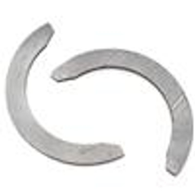

I wonder if it could be cut out and a spacer made similar to what a lot of the new engines use for thrust washers ? Use the spacer to take up the worn part. Of course I am saying this without seeing the block
Something like this:

I have straightened up the thrust surface of block and cap and fabricate a thicker thrust washer to fit and attach to block and cap with brass countersunk screws...
Mike thanks and this is what I am looking at. I am nervous of welding but that just my fears. Great group here and the input is very appreciated.
