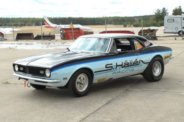

Mr. Sutherland, have you seen this car before? Look in the attachment.
Absolutely. I shipped an engine to Sven way back in the '90s! Spent many hours on the phone with him. I always intended to go visit him.

Hi, nice to hear that. I bought the car from a norwegian who bought the car from Anders, Svens son. It`s a car with very fresh body but there must be a bilion people who has drilled holes in the firewall and floor, i have welded more fifty of them!! I gone have a 350 and 200 transmission so i got som new engine mounts from OER, a disaster!! they doesn`t fits at all.
