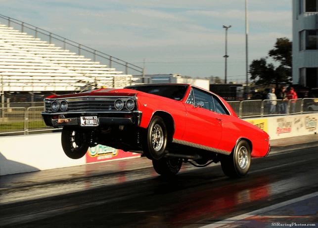

I was talking oval ports, now 291s are a different world. Bridges would be good, but there are others as well. Some like to forget..............
Name:	Vortecpro Oval port.jpg

Mark i like the red car in the pic it has nothing to do with the questions posted.
