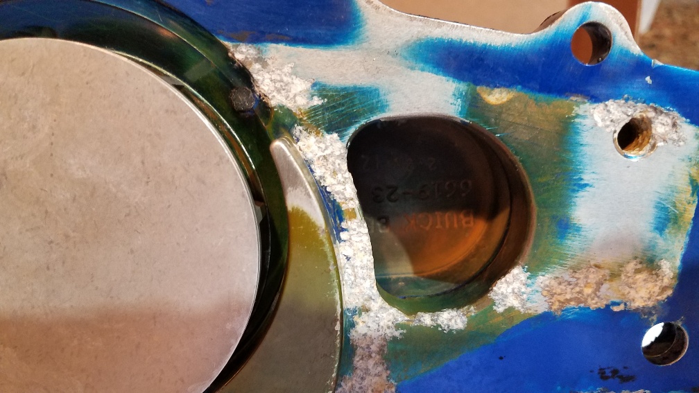

What is causing this damage to the inside of my electric water pump, and what can I do to stop it. I run just water in the system,and drain it in the fall.

I always understood when you let air get to wet metal it still corroded. I always leave the water in. How about electrolysis?

Lyn run the Lucas (* it works) cooling system additive or the redline water wetter. Both are good for aluminum blocks/heads/intakes/water pumps. It won’t allow it to corrode

Wix, #24056 cooling system treatment is also a good product and available at most auto parts stores. It is around $7.00 per quart.

What fluid do you run in the coolant system? Tap water could have some metals that will attack aluminum. Excess acidity can corrode it to. Check the Ph level of the water you use with a test kit. I run distilled water only and drained the block and pulled the water pump to change the cam this week. Lots of rust in the water but no damage to the WP.

The debate will continue about what water to use. I do know that some coolant additives state not to use distilled water. I stick to filtered drinking water for my car.

I use Red LINE.

I use distilled water and add Zerex Super Protector[ZXC04] bought at Napa was in car for 2 years and drained it this winter to change intake, intake water ports looked like new and not sign of electrolysis also run a anode in radiator petcock fitting

IF the surface we are looking at in the pic is aluminum (ie: non-ferrous), the problem is specifically from natural electrical action to corrode the material. IF that is the case, the original surface should have been anodized so as to decrease the action but would be better to use a sacrificial anode in the cooling system as well. IF originally anodized, any scratch through the finish accelerates the problem. IF the surface is supposed to be ferrous, it is surprising that it shows no ferrous oxide (rust) residue. So, it appears to be non-ferrous.
Either way, there are no negatives to use a sacrificial anode in the cooling system. Those type anodes are available at any hardware store or at Lowes, Home Depot, etc.
