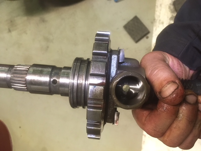

Hi folks, rebuilding old super stock tranny with manual valvebody and transbrake, and when i took output shaf out i notice that two pistonrings for governor in front of park gear, rear one was missing. governor is empty, is that left off on purpose or should i put there new one. I dont know that is the oil flow for governor blocked somewhere. Thanks in advance

No, that's the way it should be.
Thank you!!! -Pasi-

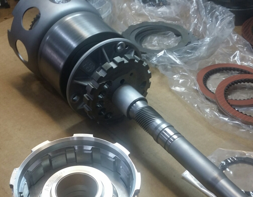

A + A makes a governor delete, a aluminium spacer that takes the place of the governor in manual valve body use

looks like this.
