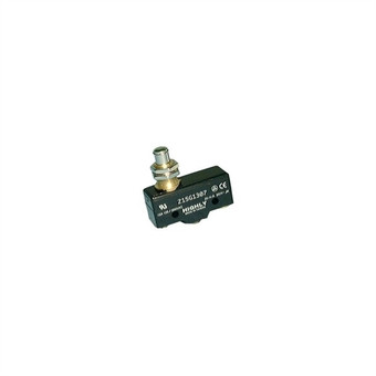

When I raced super-gas I made my own trans brake buttons from surplus snap switches available at a local electronic store for about $2.50 a piece.
This is a similar one that can be ordered for about $9.00. I just made my own shims to change the length of the button travel. I could red light easy when used with little travel.
