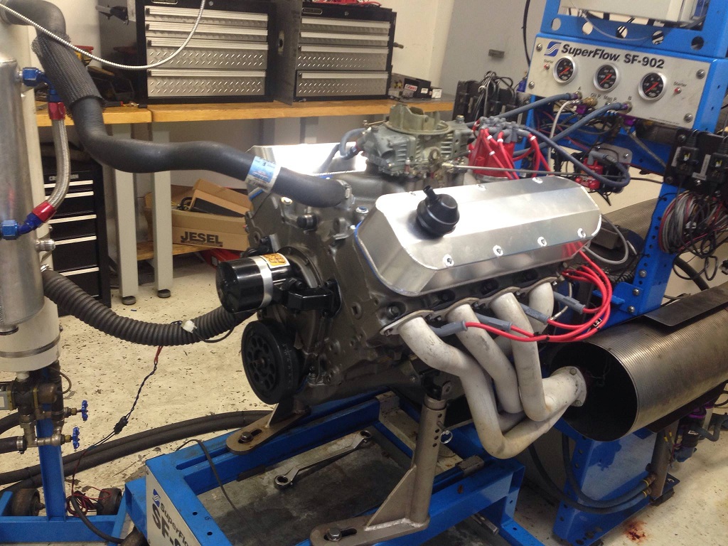

I personally took and 1850 side by side with a 3140 (the #'s correct for my 66 396) to Pomona last year and Bruce B said No Problem its OK!. You can PM me for details on this app. I already have Dyno'd this carb on a 396/325 back to back with a 3140. Also talk to Scooter Vester at Quick Fuel. He has a approved carb as well.
Since when does a center pivot dual line Holley get to replace a square bowl single line Holley? Your photo is questionable if that is the 1850 replacement.

Yes the Quadrajet is Bigger BUT it has its issues.Bigger does not always mean better. Holley is easier to tune.
As for the Holley, We have run it in several versions. Changing the bowls and metering plates is legal as far as I have been informed. The unit on the engine was the one looked at by tech.We ran in 5 carbs that day on the dyno. If for some reason someone wants to protest it changing it only takes minutes. It is just easier to tune this way. I have multiple carbs in different configurations- Centerhung dual block,Center hung 1 block 1 jet plate, Side hung transfer with jet plate. The thing was to get a tuneable secondary and adjustable floats. After all is said and done it is still 1562 x 1562 /1250 x 1313 and says either 3140 or 1850 the rest just bolts up no different than jetting, the main body is untouched and still legal. I have seen ALOT worse go through tech. Besides the Quick Fuel is legal too, Have you seen that?! It looks 10x better than the swapmeet/ebay stuff we are playing with.
