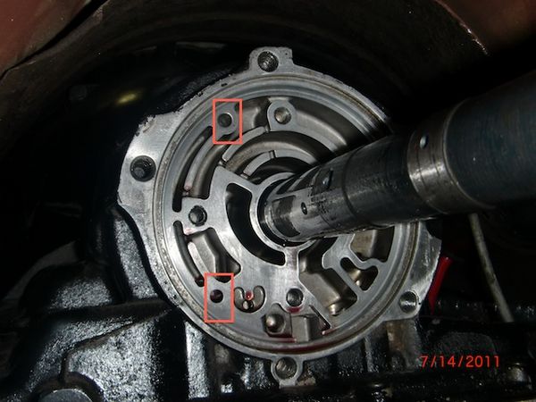

sounds like you have an early model valve body, is the top hole tapped and plugged with the bottom hole drilled? You may have to modify the case or call ATI and get the correct valve body. Either one will work, call ATI they will explain what's going on. I have had this problem before and correcting the pump passage fix the problem.
