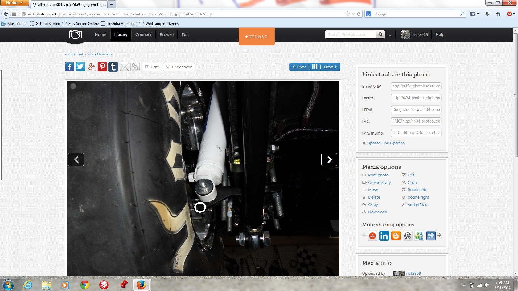

Posts: 1,651
Liked 33 Times in 16 Posts
Default Re: caltrac setup chart?
Originally Posted by Tom keedle View Post
you sure?
I was thinking 1st gen Camaros were a stud on both ends rather than a stud on top and a thru bolt on the bottom (I could be wrong)
Here is a set used on our '67 atm Tom. I went so far as to re-drill the Calvert bracket to gain an extra 1" in extension. If the dimensions are correct the Calvert 9-ways work well at a decent price.

Old 08-12-2014, 07:20 PM   #9
Tom keedle
Tom keedle's Avatar
Location: Berthoud, Coloraduh
Posts: 695
Likes: 13
Liked 8 Times in 7 Posts
thanks for the pic.......it's all coming back to me now (the Camaro shock ends)
they should work in my rambler
without losers,winning means nothing.
