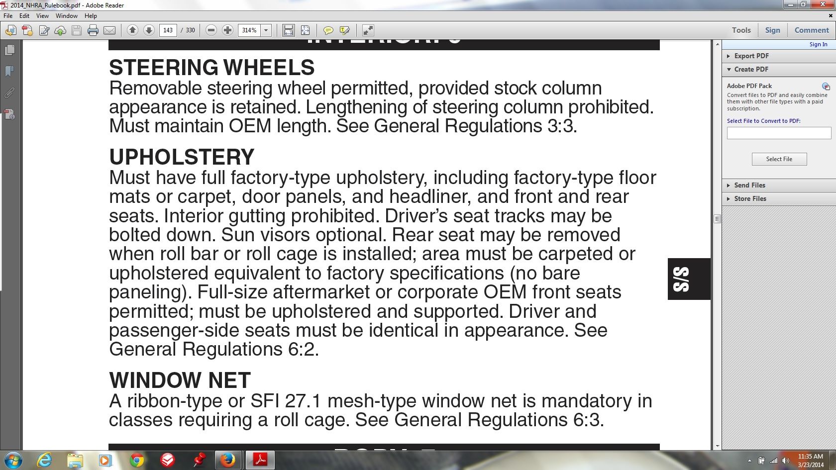

Old 03-23-2014, 12:38 PM   #3
HandOverFist
HandOverFist's Avatar
Join Date: Oct 2013
Location: Gulf Breeze, FL
Posts: 1,651
Liked 33 Times in 16 Posts
Default Re: Super Stock Interiors
Rich Taylor
I/SA - 321
Don'r forget the floor and instrument panel. but still read the book...
FLOOR
Removable floor section for transmission/shifter installation
permitted; restricted to 6 square feet (2 x 3 feet, 1 x 6 feet, etc.)
of steel material identical to area removed. Stock floor may be
sectioned where rear framerails have been narrowed. Area
between framerails must be stock floor, in original location. Area
between new rear framerails (from four-link crossmember
rearward only) and body may be replaced with material equal to
or heavier than original; must be in original location. All other
floor material must be stock and in original location. See General
Regulations 7:5.
STREET EQUIPMENT
The following are not required and may be removed: emission
controls; windshield-wiper blades, arms, and motor; heater/air
conditioning and associated plumbing (controls must remain in
dash, see INSTRUMENTS). Turn signals, etc. need not be
operative. One working headlight and one working taillight
mandatory.
INSTRUMENTS
Full stock dashboard, including instruments, fresh-air ducts, and
controls, must be retained. Heaters/air conditioners may be
removed; controls must remain in dashboard. Tachometer,
pressure gauges, etc. optional. See General Regulations 8:8.
Dale
