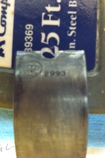

As a follow-up to the 283 build, does anyone recognize the stamp and number for this rod bearing? Again, it's at least 25yrs old. Disregard the background...I just propped the bearing up against a box to take pic. thanks for any input.

Looks like a VanderVel logo....and that is my guess....
They were around 25 years ago and I used them on some engines
Clevitte did not make H bearings yet...and the VanderVels were good...
They usually had a little more clearance than a Clevitte....
VanderVel is part of Mahle now and so is Clevitte I believe...
We used Clevittes in almost every engine as well as some C&A's and VanderVels occasionally.....

Default Re: rod bearings recommendation
Rich,
thanks for the info. I went to dad's this afternoon and found some 350 bearings with the same stamp. The good news is they were still in the box and it was a VanderVels box. They were also old as well. Dad hardly ever throws things away...it just takes time to find stuff.

And it appears that the number "2993" is the rod journal diameter (2.2993), Vandervell Set VP768.

Clevite gobbled up Vandy bearing Co. In the past you could get the same Vandy material you just add V to the Clevite bearing part number and dropping the 'H" or "P".. For instance CB 745H becomes CB745V. BTW: CB745 is the SJ Chevy number. The "V" material formula is a little softer and more forgiving than the harder "H". It works well in applications that the crank flexes a lot and the oil film gets so thin the bearing bumps the crank. IE: 282-327 SJ Engines.
