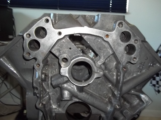

I can't remember the specific time frame, but the 426 Hemi was done in around 4-6 months from "Go" to debuting at the Daytona 500 and finished 1-2-3. I recall reading they needed to make last minute changes to the cylinder cores as the walls were splitting on the dyno. I have a friend that has a very early 426 Hemi prototype block that looks like a 426 MW AAQA casting with the drain back holes added manually in the cores.

Jim, Tom Hoover has some interesting stories on this. He tells me that they they decided the project was a go in August, 1963, and tested the first prototypes around Christmas. Tremendous for that time period.
He also told me they were splitting the cylinder walls in early Daytona SpeedWeek action, and that they loaded a couple of pickup trucks with new, improved blocks, and drove all night from Detroit to Daytona early in the week to replace them. The rest is history.
