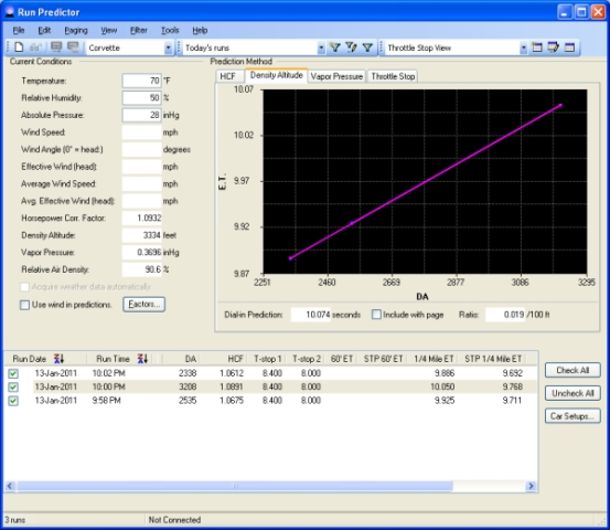

I am trying to find out if my altitude numbers I use to find out if my car is going to pick up and by how much are close, It seems like the people I talk to, say around 200 feet per hundredth of a second. My numbers are less than that,

Post or PM me some numbers and I will tell exactly what your ratio is. All I need is the Density Altitude and your ET for a hand full of what you considered good full runs (no brake runs).

I have three runs with the same set up. 9.925 @DA of 2535, 10.05@DA of 3208 and 9.886@ DAof 2338.
I have two same settings but the two are the same setup, 9.951@DA 3409 and 9.844 @DA 3052.
I thought I come up with 50 feet per hundredth, which seems like a lot of time per foot. Just trying to figure out why the feet is so low per hundreth

My prediction software comes up with .019 sec/100 ft, which is pretty close to your 50 ft/ .01 sec number. The software shows a really good prediction line with the data your provided so I wouldn't worry about it too much. See the attached image.
The other two runs yield a ratio of .030 sec/100 ft.
I could see a smaller engine being more air sensitive. A relatively small change is going to mean more with a smaller displacement engine than with a larger displacement engine.
Again, if you seem to be coming up with the same ratio all the time, don't worry about what other guys have. Based on the numbers you provided, it looks to me like you have a pretty predictable combo.
