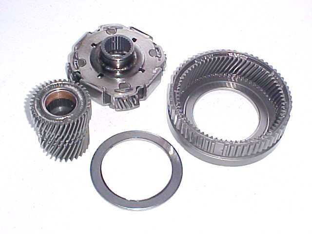

Copy and paste. Look at the sun gear all the way on the left. It has a indented boss or ring around the top of it. The non low gear doesn't have the ring. I think if you remove the valve body you can see this . Old 80s police cars 360-318 had them check the bone yard for it. Also old cop cars also turned into taxi cabs so check there too. Hope this helps.
http://www.aandatrans.com/Images/products/12135LG.jpg

Originally Posted by dartman View Post
the 2.72 have a bigger sun gear
do you see how the sun two differant size gear on it.
