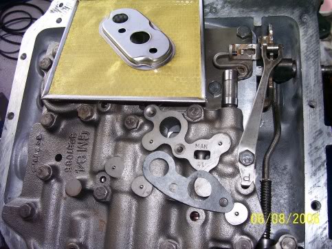

Check the manual valve,make sure the "s" clip not bent. by putting it in low gear and making sure that the manual valve is level with the end of the valve body." i think,it's been a long time $ents i did a 350"

if the manual valve is out of adjustment.it could bleed into the 2nd gear passage and apply the intermediate clutch, it would lock up the transmission.
