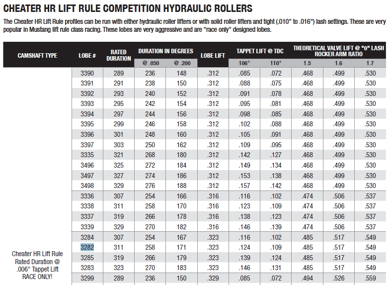

Can someone help me I.D. this cam? #'s etched on cam are:
3282B/3285
HR 8
looks like CC or CL
Y7899
Thanks, Mike

Here is the Comp Cams Listing.The "B" means that that lobe has a small modification from the listed specs.
Stan

Also if you call Comp and give them the Y7899 serial number they will e-mail you a cam card so you will know exactly how the cam was ground. Just got one from them a week or so ago.
Bill Koustenis
