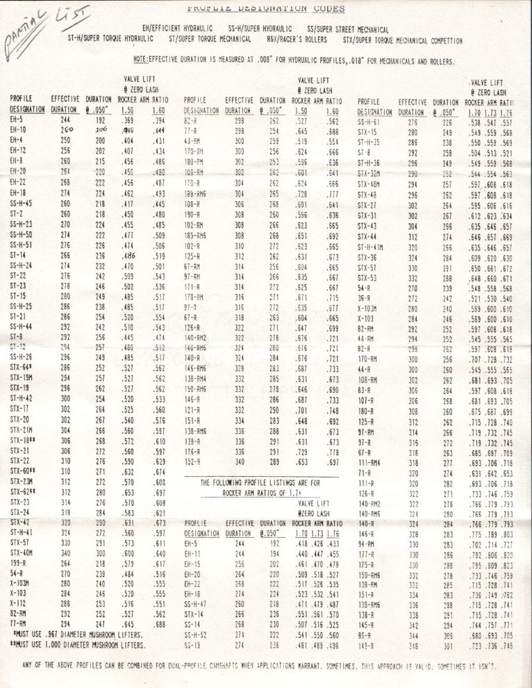

I found this handy chart, looks like older cams but with Advertised and .050 duration. Just lobes, no LSA given.
The 72-R isnt on there & there's no correlation between the cam number and duration. IT does seem like, for the rollers, the .050 duration is about 40 degrees less than advertised, give or take a few.
