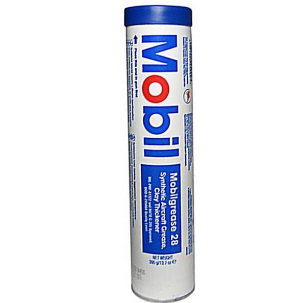

Jerry Bickel, and some other chassis shops sell this Mobil 1 # 28 synthetic grease
