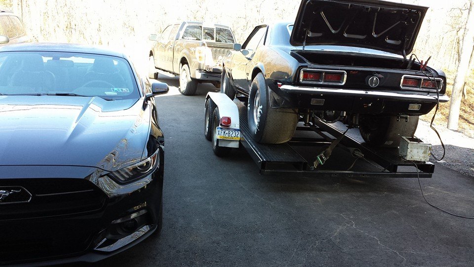

Default Re: flat bed, open trailer
Me and a friend bought 2 trailer city gold rush 18' open trailers from Fred Hartman (G/MP fame) with consecutive vin numbers in 1983 I sold mine in 1990 and bought my buddies a couple of years later, I still have it to this day! best towing open trailer I have ever owned or used!
