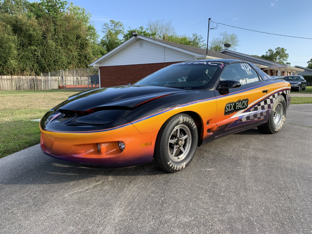

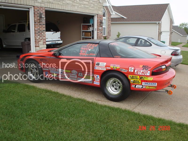

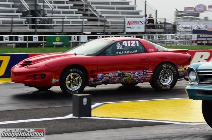

Here are some pics of what I am seeing. I'm not really interested in 'breaking the rules' so I am trying to figure out how everyone else is doing it. Glenn, I will definitely keep yours in mind. Right now my cash is going towards a trailer that I will pick up in a week or two.

KRatcliff
Join Date: Sep 2011
Posts: 769
Likes: 75
Liked 534 Times in 143 Posts
Default Re: 4th Gen Rearend
Since one of those pics is my car I guess I will answer with what I know at the moment. The rear end is a 12 bolt with the stock width and coil spring mounting locations. It has the stock springs and I don't know offhand what the rear wheel offset is, but they are 10" width Weld Alumistars. I don't have any trouble with clearance.

The rear ends under these cars are not stock width, a stock width rear end would be too wide. Most of the f body cars I've built had a 60" or so axle flange to axle flange rear end. As mentioned earlier if you have the wheels and tires that will be used on the car you can get a more accurate measurement.
