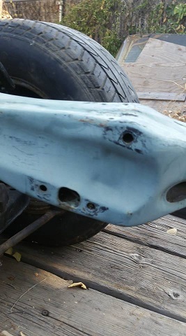

Thanks Jim That'd be perfect. You got to think that would fit. What's odd, on my frame there's only two holes. I've never seen a GM box with only two holes. Is your box a 2 holer?

My Firebird came originally with a manual box . The box has 4 threaded mounting lugs but Pontiac only used 3 bolts to hold it in . Never heard of a box that is only held in by 2 bolts , that's weird . The A body box is the same , but has a different pitman arm .

I know. I'm going to take a pic for everyone.

oh.....crap. Working at night to keep outa the big heat caused me a slip up. Just went out and looked and found the missing hole..... in my brain. Single hole by itself on top. Well, good. That's one thing out of the way
