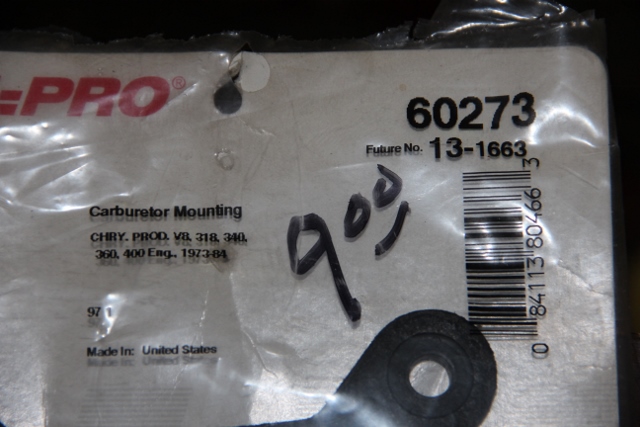

Bought theses off Mike Keown many years ago. They are 1/4 inch thick

Jeff, I think that open style gasket is OK for a open plenum intake manifold,, but on a stocker cast manifold, it should be a 4 hole , shouldn't ?

For what its worth, several years ago we tested with the open gasket vs. the 4 hole gasket on the dyno and the 4 hole gasket made slightly more power and torque with our combination.
