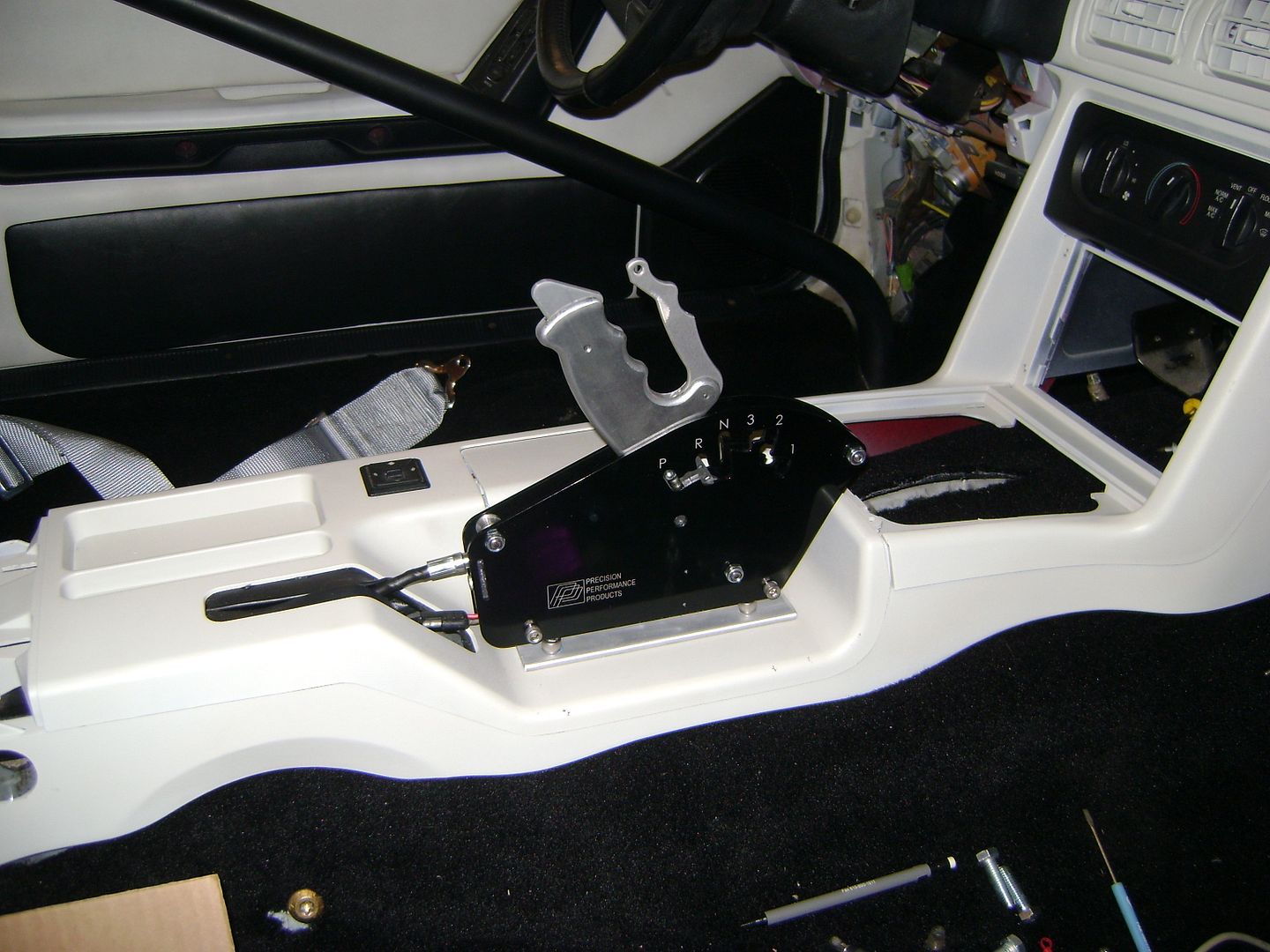

I use the TurboAction in the Camaro with a metric, but considering changing it out for a PPP shifter soon.
http://www.precisionperformance.com/home.htm
